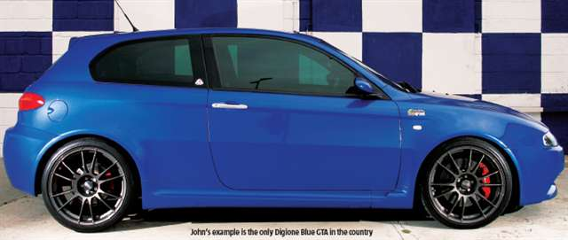

Hi!
Unfortunately my German is not to good but I found your website interesting. I work in Saudi Arabia but home is South Africa & I own a 147GTA, I had a 156GTA previously. I think you might find my car interesting & it was recently featured in MaxPower SA. No this is not a car that has been spoiled by ugly aftermarket body kits & the like however I am very good friends with two of the worlds foremost Alfa tuners, Dawie De Villiers of Glenwood Motors in South Africa whom I have known since my late teens (a friend of my father’s) & Jano Dedajan (managing Director of Autodelta). Being a Greek & living in SA, well Dawie is South African & Jano is a Greek.
Let me tell you a little about the car. It’s a very late model 2005 & registered in SA in January 2006. The car is blue with a 2 tone leather interior, tan on black. The exterior is standard GTA bar the OZ/Autodelta 8X19” Ultralegerras, fitted with 225/35ZRX19” Pirelli PZero Corsa’s. Now that’s a hint to the rest as Dawie is the Wildman globally when it comes to Alfa’s & here we use a combination of Autodelta & touring car parts to complete the car:
Engine - First step of tuning
1).3.7L Autodelta Stroker kit but with upgraded pistons, Ross forged race type & Pauter Machine forged conrods, all blueprinted & balanced & the compression ratio increased to 11:1.
2).Gas flowed & blueprinted cylinder heads fitted with Newman Racing Cams big valves, 304 degree Newman Racing Cams & solid lifters.
3).Autodelta/Ferrari 360 throttle body & Autodelta Carbon Intake System.
4).Group N exhaust & branches by Dawie De Villiers with Autodelta tailpipes.
5).Autodelta modified ECU with 8000rpm limiter, map to suit throttle body & camshafts plus a Unichip piggy back unit to enable fine tuning fitted by Dawie De Villiers & Dastek.
Transmission
Standard GTA fitted with Gemini LSD & Competition clutch assembly
Suspension
1).Autodelta Sport Corse adjustable shocks (height, dampening, rebound)
2).Autodelta control arms(upgraded)
3).Eibach roll bars
Brakes
GTA 330mm with Xdrilled Autodelta discs all round, up rated brake pads & stainless steel braided lines
355mm, 8XPiston Praggia (the units used on the GTA 3.2 Production Race Cars in South Africa). Race pads are fitted as are Autodelta braided SS lines, Autodelta Xdrilled rear discs are used.
Wheels
Autodelta/OZ Racing Ultraleggerra 8X19” fitted with 225/35ZRX19” Pirelli PZero Corse
All work carried out by Dawie De Villiers of Glenwood Motors
Power=280kW@7400rpm (<- 381 Porno PS!!! :shock: )
Torque=415Nm@5000rpm
0-100km/h=4.8secs
Vmax=294km/h
*All tested by GPS & Verimax computer in SA by test authority
Believe it or not, the car is set-up on 93RON fuel unleaded (it losses some hp but it’s safer, 15hp at the wheels to be accurate), pulls from idle in 6th-cleanly, revs like an F1 car all the way to 8000rpm in every gear, is not noisy, the Group N silencer meets all emissions, makes 115hp more at the wheels than a standard car. In fact at 4000rpm it has the standard car beat. Torque is above 300Nm at the wheels from 1600rpm & never drops below this figure until 7200rpm.
I have covered 10000km in this car & it’s been the drive of my life & I have owned M3 CSL’s……………..etc.
This is what the GTAm would & should have been. I beat a CSL hands down in this car, a V8 M5 anywhere, a 355 Ferrari, RS4’s, it’s an amazing little car. I also won the SA Alfa Club concourse with this car, outright. I maintain it impeccably.
I have kept the cars character & added 100kW & 110Nm to the mix & it takes it in it’s stride.
Now we are building another 3.7L stroker motor but with standard camshafts & decompressed to 9:1. Jano from Autodelta will come to SA & him & Dawie De Villiers will fit the Autodelta Supercharger kit but running at 1bar instead of the usual 0.5bar (special order). This will produce around 520-540hp & 600Nm
FORZA GTA!!!!!!!!!!!!!!!!!!!!!!!!!!!!
Ciao, John

Meiner Meinung nach ein mehr als hammerhart pornomässiger GTA! So wie er eigentlich ab Werk hätte rauskommen sollen!!!...
Ja, der muss hier auch gezeigt werden... Einzigartiges Teil.. Und freute mich den ganzen Tag auf den Bericht und Video's.... :twisted:

aber hat er ein diff drin???
weil sonst bei der leistung da vorne :shock:

momo66 hat geschrieben:aber hat er ein diff drin???
Transmission
:wink: ...
momo66
Beiträge: 4304
Beitrag von momo66 »
öhhh und auf deutsch? :oops:
LSD (Limited Slip Differential) also ein Sperr Diff. von Gemini :wink:
und "Competition Cluch Assembly" heisst soviel wie eine verstärkte Rennkupplung...
Wird wohl auch alles mehr als nötig sein bei der Leistung :twisted:

Heisses Teil, nur hab ich nirgends Info's zum Getriebe gefunden?!
Der wird ja wohl kaum schlussendlich ¬550PS auf das normale Getriebe loslassen wollen? Das Drehmoment wird mit Zwangsbeatmung schon heftig steigen.
Schon die 380PS mit dem Drehmomentzuwachs dürften grenzwertig sein.
Jedenfalls ein absolut geiler Stuhl nur sowas dann mit Frontantrieb zu realisieren ist schon fragwürdig.
Aber mit dem Teil RS4 etc zu verblasen hat sicher einen mehr als hohen Spassfaktor ;)
Aber wenn er soviel Kohle hat könnte man auch gleich auf RWD umrüsten, klar eine schwierige Operation aber möglich ist alles.

Geiles Ding wirklich, wobei für die neue Angestrebte Leistung eher ein
sinnloser Aufwand ist bei einem Fronttriebler, schon 380 PS ja alles
andere als ohne, selbst für einen Allradler....
